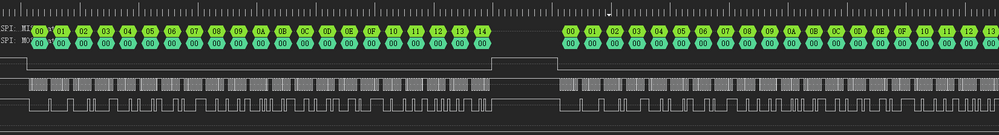

I am using S32G-VNP-RDB2 S32G274A_M_core to implement spi slave function,But I had some problems
I create Spi_Ip_Transfer_S32G274A_M7 example project, and I can send spi message with function Spi_Ip_AsyncTransmit, but whenever I change the variable in the array, this function still send the initial value
uint8 TxBuffer[NUMBER_OF_BYTES] = {0x00, 0x01, 0x02, 0x03, 0x04, 0x05, 0x06, 0x07, 0x08, 0x09, 0x0A, 0x0B, 0x0C, 0x0D, 0x0E, 0x0F, 0x10, 0x11, 0x12, 0x13, 0x14};  //  the array to be sent

Spi_Ip_AsyncTransmit(&Spi_Ip_DeviceAttributes_SpiExternalDevice_0_BOARD_InitPeripherals, TxBuffer, RxBuffer, NUMBER_OF_BYTES, NULL_PTR);
    do
        Counter --;
        Status = Spi_Ip_GetStatus(Spi_Ip_DeviceAttributes_SpiExternalDevice_0_BOARD_InitPeripherals.Instance);
    while ( (Counter > 0UL) && (Status != SPI_IP_IDLE) );
it is very strange, if I use Spi_Ip_AsyncTransmit to send several different arrays, it can send their initial variables correctly.
And I use Spi_Ip_SyncTransmit to send data, it can send the modified variables correctly, but I don't want to use it because I want to use SPI slave mode and this function will block when waiting the master.

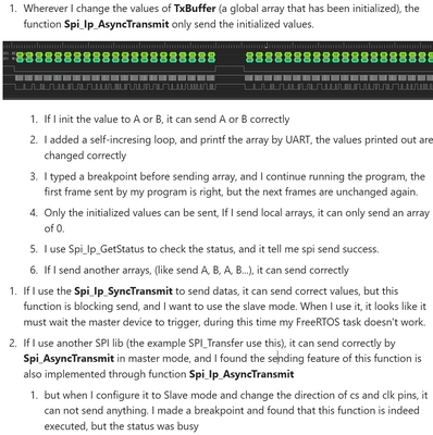

Then I close the optimiztion, and  my cs pins don't work. And I found that the data segment did not change.
Now I suspect that this problem is related to DAM or optimization.
My other attempts are also written in this png, I have been spending days on this issue, If you can tell me how to configure slave mode with SPI library is also OK, then I can skip the problem of SPI_IP library, Thank you!

For faster debugging and to avoid running master device for a long time, I temporarily configured my SPI peripheral to master mode.
I find that this project's default optimization setting is -Os, I try to configure it to -O0 then it cannot send anything. Only I turn on the optimization, the spi master can send messages, I don't know why.
