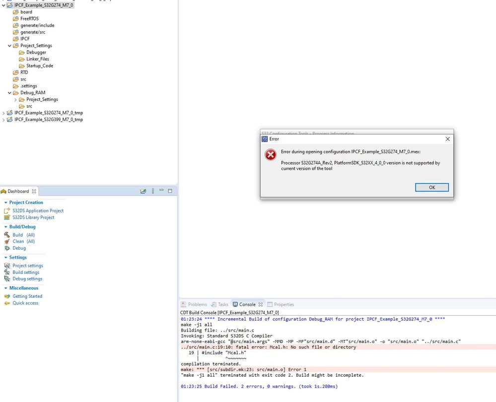

I noticed that the BSP35 has been released officially, and IPCF demo is updated to v4.8, but the demo need to be build by self. And I tried to build the demo with v4.8 update site installed into S32DS 3.4, but build failed with the following error:
So would you please help to check the issue and fix it or give a workaround for it?

The problem seems to be related to S32DS v3.4 not supporting the release of IPCF you are working with. Could be that S32DS v3.5 is the one with the support for your specific set-up.
As for the BSP and IPCF versions, could be that you were given access to non-public releases. As for them, we recommend sending this inquiry to your local NXP representative for them to redirect them as needed.

you can try to update S32 DS version to 3.5, my version is 3.5.1 and I can click mex file .

I installed S32DS 3.5 and build IPCF 4.8.0 out finally.
