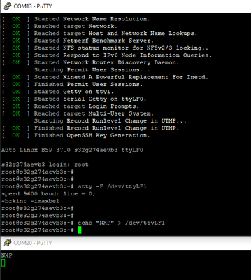

Hi NXP Community,
I want to use the UART1 on our board (referenced S32G-VNP-RDB2) in Linux System.
As I execute "echo "XXX" > /dev/ttyLF1", I could not probe the signal on UATR1 TXD.
I could not communicate with other PC using minicom through UART1 either(I use BSP_37).
How could I use  the UART1 in Linux System?

Daniel-Aguirre
It seems that modifications to the device tree are required. Once we modified the device tree, we are able to ping through UART1:
Since you are working with an RDB2, the following modifications should be done under the "linux\arch\arm64\boot\dts\freescale\s32gxxxa-rdb.dtsi" file:
DanielAguirre_1-1708970527046.pngDanielAguirre_1-1708970527046.pngDanielAguirre_2-1708970548077.pngDanielAguirre_2-1708970548077.png
Once modified, the image needs to be compiled. Once compiled, the following files need to be replaced under the "boot" partition of your SD card:
  • Image file > linux\arch\arm64\boot\Image
  • DTB file > linux\arch\arm64\boot\dts\freescale\s32g274a-rdb2.dtb
With that, you should be able to use UART1.

Thanks for your feedback. As shown under our previous image, we are using BSP37.0 for this modification:
As for ttyLF1 not being available, since the modifications we shown are only related to pin mapping, the serial1 device should not be affected. Can you help us share the full boot log of your system? Also, help us adding the following command to your log:
dmesg | grep ttyLF1
As a note, we compiled Linux manually then copy the previously mentioned files into the boot partition of our SD card. The base BSP37.0 image we used was the pre-compiled image provided by NXP (under a *.tgz file).

Daniel-Aguirre
At this moment, EVB3 is the platform we have available. Still, the steps we provided were on regards of RDB2:
Are working with Yocto project or are you building the component manually? Can you help us share the respective logs from your setup?

Daniel-Aguirre
Thanks for your feedback. If you are not able to see ttyLF1 being listed, then other changes may have been made. We were able to get our hands on an RDB2 and we can see the same outcome as before:
