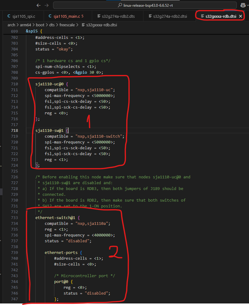

Hi all,
Currently, my project is using SJA1110 on S32GRDB2(run linux OS - BSP 42) for my application. By default, i am using setting (1 - below image) in device tree, not using DSA and using S32DS for configuration. This makes it impossible for me to use switchdev command to control switch in runtime to dump MAC table of SJA1110.
So, I want ask a question "How can i dump MAC table in runtime, Is there any mechanism or way?". Because when i using setting (1), when board is booted up, only have sja1110 kernel module (which is responsibility for loading static config, not doing anything more) and don't have any tool or kernel module to I can interact.
Plz suport me, as soon as. Thank you more

Hello, @dungdungxmxm
Thanks for your post.
I understand that you may be working with the default sja1110 drivers built from BSP42.
From your current testing environment(using S32DS for configuration), "dump MAC address table in runtime from Linux host" is not supported based on current BSP.
I apologize for your inconvenience.
Chenyin
