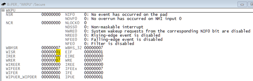

Hello Harry,
I’ve tested on my side, and there is no such issue.
I set 3 wakeup sources as WKUP0, 1, 2 (MSCR43, 146, 148) and enables those by WRER.
I tried to wake up by WKUP0, and successfully waked up and the WISR value was only source 0 like below.
Please refer to below register setting that I tested with.

johnyoo
Hello Harry,
If the wake-up signal occurs, the WKUP will record the event through the WISR register.
Please refer to the WISR register in S32G RM.

johnyoo
Hello Harry,

harry_choi
Hello John,
When I tested again, I confirmed that I could read wakeup source by following your advise.
Maybe there had been my mistake which read another register and so on.
Thanks for your support and solution.
