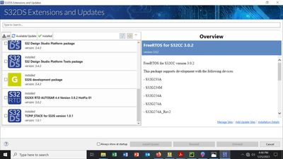

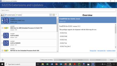

i found the TCP/IP stack and it is installed in the S32 Design studio, i am trying to compile the lwip_s32g274a example, but i am getting error in freertos,
I have added the Packages of FREERTOS, RTD, TCP/IP Stacks are all installed in the IDE,
Kindly help me in fixing this error,
6,465 Views
Naveenkumar_Muthusamy
Hi Daniel,
I am able to compile the project, i had a issue with the packages installed in the PC, so now build is fine
