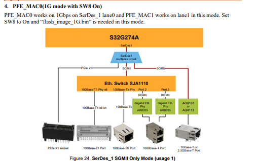

Hello @won0020,
Sorry for the late response, the team has been somewhat overloaded these pasts weeks.
About your problem, I can recommend checking S32G-VNP-RDB2 Ethernet Enablement
Guide in which you can see how to achieve different configurations of PFE outputs, in particular I can recommend checking section 4. PFE_MAC0(1G mode with SW8 On)  which is related to your problem.
Please consider that you may need to request access to the SJA1110 SDK which requires to sign an NDA. To do that please contact your FAE/DFAE/NXP representative.
Let me know if this information was useful.

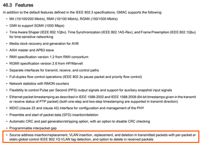

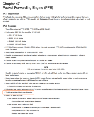

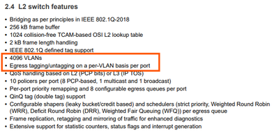

alejandro_e
Hello @won0020 ,
Yes you can configure the VLAN in the SJA1110 switch itself, as you can see in the datasheet [page 3, Rev. 2 — 8 December 2023]:
But you can also configure it in the GMAC of PFE of the S32G2 [page 2223(GMAC) and 2229(PFE), S32G2 Reference Manual, Rev. 8, February 2024]:
Let me know if you have any other question about this topic.
