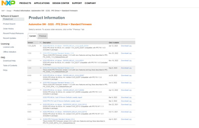

vinaybhat88922
Thanks for the response. Where do i find the document "PFE QNX Linux Driver User Manual". I check both nxp and qnx website (i have relevant license). In NXP webiste i only see the following
and none of this point to the document you are referring to. can you please let me know where to find this document.
3,526 Views
Daniel-Aguirre
If available to your account, the PFE+QNX driver should be available under the page you are showing. Given that no information is provided under that page, then it seems that your account is not enabled for that specific software/firmware.
For that, help us contacting your local NXP FAE/DFAE/representative, for them to proceed as required, if possible.
Please, let us know.
