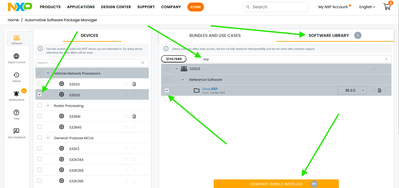

I was under the assumption that you were well familiarized with the source code for our BSP. sorry for the misunderstanding, now that I know that, I would recommend porting your application from the green hills to the u-boot source code. You can check all BSP related code in nxp-auto-linux, at the moment the most relevant ones are u-boot and arm-trusted-firmware you will need both to generate a bootable binary. Once you have you can define a new command that runs the application you want, for example, you can check the gpio.c as a base both for a new command and to manipulate the GPIOs, you can download the documentation to know how to build everything in AUTO-SW-PACKAGE-MANAGER:
For example, in BSP44 you will need to check 3.2.2.2 Building the U-Boot bootloader and 3.2.3.2 Building the Linux Kernel, you can do it in a Linux native machine, Linux VM or even in WSL, the latter is the easiest in my opinion, if you decide to do so and you will try the Yocto build, please check the following post Build-NXP-Auto-Linux-Yocto-BSP-on-Windows-using-WSL to avoid any problems with Yocto.
