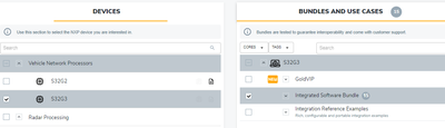

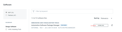

For S32G3, the RTD packages should be available under the "Automotive Software Package Manager":
Which is available under the S32G3 product page (link: S32G3 Safe and Secure Vehicle Network Processor | NXP Semiconductors). There you should be able to create the bundle with the packages you want to use. The RTD's are the first recommended package on regards of M7 development, since all other packages are added as plugins to the RTD. We recommend selecting the following options:
Then click the following button down on the same page:
Since the bundle will require approval from the NXP related team, the bundle could take up-to 48 hours to be available. You should receive an email when this happens. If not, then let us know for us to see the follow up.
