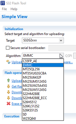

we are trying to boot the M7 core 0 from s32g2 in our system. we understood that the s32 flash tool is needed to flash the code to the external flash memory.
The issue we are facing is, flash memory used in our system is Micron, which is not available in the s32 flash tool. then we tried to create an algorithm file using the flashSDK project in s32flashtool folder under NXP, which was also failed to cretae a communication with flash.
here, we need your support for flashing the code without using the S32flash tool.we need to know is there any other way to boot the S32G3, A53 and M7 without using the s32 flashtool from the QSPI flash.

we were using S32 flashtool 2.0.3 and we have updated it to the 2.1.2.
we used an example project under the flashtool folder FlashSDK/Qspi. we modified the qSPI_chip_commands.h according to the commands used in the micron flash in our board(MT35XU512ABA), and ran the project on debug mode.
In debugging we are successfully able to read the ID of the device, we are able Erase, we are able to read and write 100 bytes with the project.after this we have changed the project to the release and added the binary file in flash folder and updated flash_devices XML with the device name and binary name.
Now s32 flash tool shows the micron device used in the board. but still we are getting error massage saying failure to establish the communication with target device as soon as i press test connection.
Q1 -> for serial download to QSPI, what are the boot configurations Pins, what is configurations that needs to be taken care.as of now, we see that algorithm file seems to be fine, we need to know about the DIP switch configuration needed to put the device in serial download mode via s32 flash tool.

We understand that, under the following version of S32 Flash Tool:
There was an addition of 2 memory algorithms from Micron, as shown below:
Don't know if they are still not the memories you are using. There could be also the possibility of loading the image serially through UART/CAN interfaces. The following threads talk about this situation (from UART interface):
