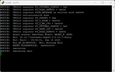

I am using a custom configuration of a board based on the S32G3 RDB3 board as reference with the BSP43. The build runs through but while flashing with the fip.bin-qspi & flashimage.bin file, the bootloader hangs after executing BL2. It is not going into the BL31 function. (See screenshot below).
I have applied a patch to debug. As per the log on the UART console, the entry point address for BL31 is set to 0xFF600000.
As per the BSP43 UM, the base address for the BL31 is mentioned as 0xFF800000.
Could you also share the details of the BL31 & BL33 sizes so that we know if we need to translate addresses.
Require support for debugging this issue.

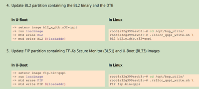

2. Commonly, when using BSP42 or earlier, the fip.bin would be flashed to the QSPI, but since BSP43, the boot image for A53 side is split into 2 images, then you may need to flash the  bl2_w_dtb.bin to the QSPI instead of fip.bin.

1. If you are willing to directly flashing the  fsl-image-flash-s32g399ardb3.flashimage, then it includes all images that used to boot from QSPI, you may not need to flash other images that generated.(like fip.bin-qspi mentioned)
2. If you are willing to only flashing the Bootloader part(TFA and uboot), then you may flash the following two images step by step as follows: Chapter 4.2.5 of BSP43UM for S32G3
Chenyin
