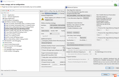

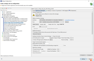

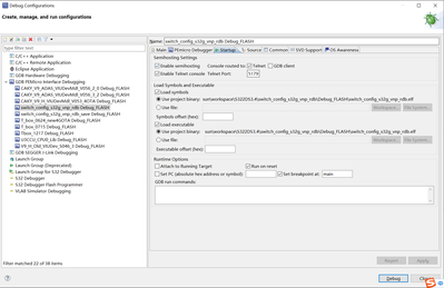

When the s32G274RDB2 was downloading the program using the SJA1110 PE downloader on the switch, the debug operation was normal. However, after repowering, when the switch was set to start from flash, the program would not be updated to the latest downloaded version. I want to know where the problem lies with my PE debug Settings?  Moreover, a month ago, I was able to download it normally, and when I repowered it, I could update it to the latest program normally.

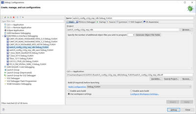

Sorry that I have not reproduced the issue from my side, by checking the logs shared, I do not see the log for VM and other commands, and I mentioned that seems you are still working with S32DS3.4, but combining with the SJA1110 SDK 1.0.2?
Since SJA1110 SDK 1.0.2 was released and tested on S32DS3.5, would you mind retesting it on S32DS3.5 for a trial?

1. What is the switch setting when you flash the spi of SJA1110 and after repowering?

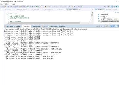

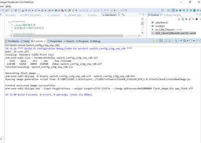

2. When flashed the binary, have you checked in the console with command VM? what are the prints?

1、The dial-up operation should be carried out according to the following figure.
2、Print as shown in the following picture.
