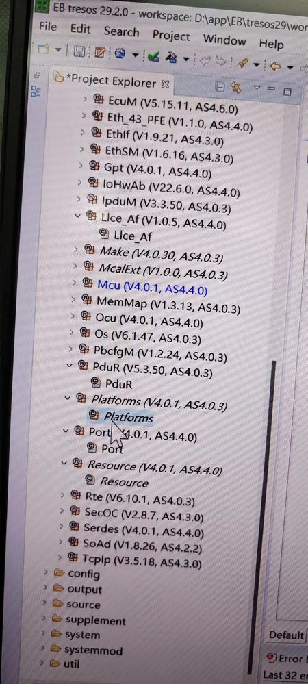

Q1:I want to add the function of multi-channel CAN routing to the Goldvip gateway eb project. I have completed the Can2can routine for Canif , LLCE_ AF, CAN_ 43_ LLCE  module, but when the configuration is interrupted, the platforms module cannot open the configuration interrupt. How should I solve this problem?

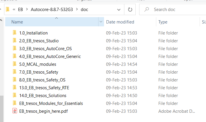

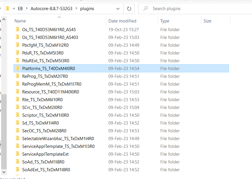

Some of the modules included in the GoldVIP Real-time Gateway application are specific to the EB tresos AutoCore stack. That's the case for the Platforms modules they are trying to configure - there is nothing to configure there.
For info regarding the EB-specific modules, please check the doc folder from the EB tresos AutoCore installation directory.

How can I solve the problem where the configuration interface cannot be opened after double clicking on the platforms module?
