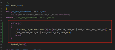

HI,
I operate according to the AN13750 documentation, but there are different result for different Board version
For S32G274Ardb2 Board Version Rev.D, this part of the code will execute normally, but for S32G274Ardb2  Board Version Rev.E it will block in an endless loop.
The guidance in the AN13750 documentation is specific to which version of the board?
Board Version Rev.C、Board Version Rev.D 、Board Version Rev.E?

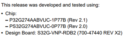

Rev E of RDB2 uses the silicon revision v2.1, while Rev C/D uses the v2.0 revision.
Since AN13750 is intended to be used with HSE v0.1.0.5, we understand that the specific version was released prior to the new silicon revision (S32G2 v2.1), hence the guide was verified with v2.0 silicon revision. If we look into the HSE v0.1.0.5 release notes, we see the following is stated:
The first HSE version that supports v2.1 silicon should be HSE v0.1.0.9, in which the release notes state the following:
Since we understand that your board is being stuck under the HSE verification routine, we assume the issue is due to the HSE version being used under AN13750 is the v0.1.0.5, since it does not support v2.1 silicon revision.
