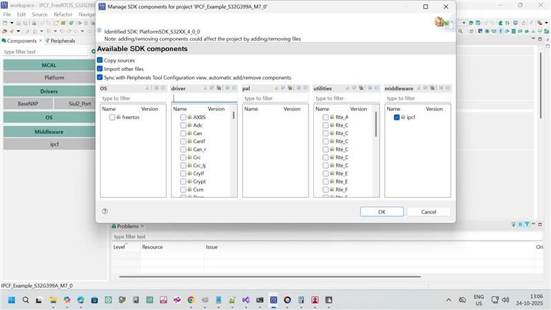

Hi @Joey_z
We’ve successfully established IPCF communication between the M7 and A53 cores on the S32G3 SoC using the M7 IPCF example provided in the updatesite.
We’ve also developed and tested our own application that currently does not include IPCF functionality. Now, we’re looking to integrate IPCF into this existing program.
We followed the steps shown in the image below, but encountered some "variable not found" errors during integration.
Could you please suggest the correct approach to integrate IPCF functionality into our existing code?

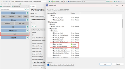

hi,Niranj_369
Thank you for contacting us.
You can try to add the ipcf Middleware as the following picture, I used the UART demo and added the ipcf module into the application. Then, click the "Update Code" button to add the ipcf code in the project.
Hope this can help you.
Joey

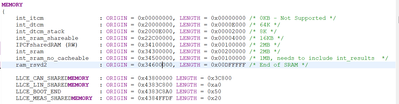

I've integrated IPCF into the LIN code and successfully generated the binary. However, I'm encountering the following issues:
  1. LIN functionality works as expected, but after loading the M7 firmware, the serial terminal displays garbage characters. I'm unable to access the terminal or proceed with booting the A53.
  2. IPCF functionality is not working. I've included the ping-pong logic from the IPCFG example, but it doesn't seem to respond.
Could you please suggest fixes for these issues? I've attached the linker script below for reference.
Note: I have used the correct load address and also verified the lin and IPCF examples seperately.
