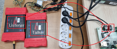

I am using S32G-PROCEVB-S and S32GRV-PLATEVB in stacked mode. I know that sja1105qel on S32GRV-PLATEVB support AVB protocol. And I have tried to transfer AVB packet  by the simulator. But I have checked that AVB is not worked. The following is my AVB test environment.
To enable sja1105qel, I have done the following. And I have checked that sja1105qel is worked as the switch.
But I have checked that AVB is not worked. So I think that sja1105qel support AVB protocol but the firmware(binary) is not support AVB. I have checked the firmware on the u-boot source code as the following.
1. Does the firmware exist to enable AVB protocol for sja1105qel on the u-boot?
2. How can I modify the firmware(array) in the source code on sja1105_cfg_evb.c to enable AVB protocol? (Is it possible?)

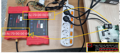

I have tried to apply sja1105QS_TSN.py into the target system. But AVB is not worked. So, I have tried to changed SRCMEAT/DESTMEAT of the avb_parameters from 0x026037C0FFEE/0x026037DECADE to 0x00fc70000003/0x00fc70000004 because the Talker(SRCMETA) is 00:fc:70:00:00:03 and the Listener(DESTMETA) is 00:fc:70:00:00:04. But not worked.
This is my system for AVB. If I miss some point to enable AVB, Would you give me the information?

DESTMETA and SRCMETA are the values of meta frames address fields.
They are _not_ the addresses of the communicating stations. Meta frames
convey timestamps to the host. They are discussed in Section 7.3.4 of AH1704.
Please familiarize yourself with the recommended documentation to acquire
sufficient understanding of the equipment/feature you are working with.

I solved it with your advice.
