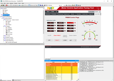

I'm testing my own BLDC motor on MCSXTE2BK142 daemon board.  With freemaster runs on PC and MCAT tools could run normally. I MCAT tools enters error status after clicked the ON button. The MCAT shows GD3000 error,as following.
I'm not sure what happens.

I checked the dcb_v_pos voltage ,it's 12.1

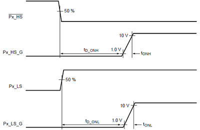

Low VLS error means the power supply for the gate drives is under voltage. The VLS under voltage threshold is between 7.5 V and 8.5 V.
Maybe there is something wrong in your HW/SW. Here are some suggestions for you:
  • Check your PWM polarity. Note: the high side is low active and low side is high active.
  • Increase the deadtime of PWM
  • Check you motor control SW/HW
BR, Joaquin
