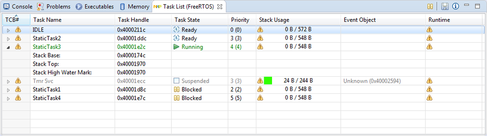

please check below screenshot, I created a task by xTaskCreateStatic, and named as "Task".
this task is started, I set a breakpoint in my task, and the PC is stopped. then I refresh the "Task list" of FreeRTOS debug plugin, but my task info doesn't show up. (it showed up some times, but some times no, I don't know why)

jiri_kral
I tried your scenario on modified example project (in attachment if you like to test it on your machine) - and I can't reproduce your issue. All static tasks (4) are shown properly for me all time.
My FreeRTOS Task Aware Debugger for GDB version is 1.0.2.201704260904
Jiri

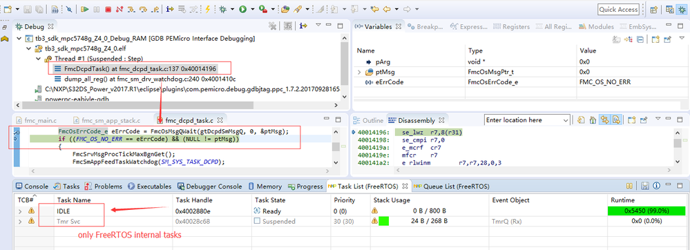

dkageff
Hello.  I have a similar problem when trying to debug a FreeRTOS project running on an MPC5748G evaluation board.  I have installed S32 Design Studio for Power Architecture 2.1 and am using the demo project freertos_mpc5748g.  When I run the program, I only see the FreeRTOS system task in the Debug window (see 'Debug window' attachment) , however I do see the four LED tasks when I do a FreeRTOS task list (see 'Task list' attachment).  The project uses FreeRTOS v10.0.1. will try the modifications to FreeRTOSConfig.h described above.  I did check tasks.c for xDelayedTaskList1 and xDelayedTaskList2 and they appear to be globals in tasks.c.  Thet are defined with the PRIVILEGED_DATA macro but that seems to be a blank definition.  Is sthere anything else to look for/try?
12,787件の閲覧回数
dkageff
I forgot to mention that I am using the 'debug_ram' configuration and have the PEMicro OpenSDA interface selected.
