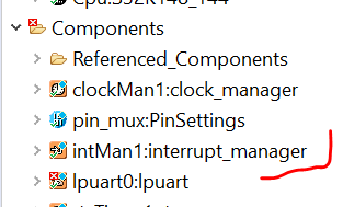

Hi , I opened an project on SDK 0.8.4 EAR, there is a component in PE,
I try to re-config the project on SDK 4.0.2 RTM, but i can't find the Interrupt_manager , not in Drivers, nor in PAL.
How can we handle the interrupt manager in SDK 4.0.2 RTM?

Hi samcs,
You can find Interrupt Manager (Interrupt): C:\NXP\S32DS.3.4\S32DS\software\S32SDK_S32K1XX_RTM_4.0.2\doc\Start_here
