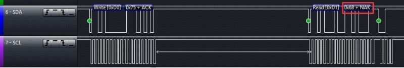

   i use flexio_i2c_s32k144 demo code to test.
  but find the read value is not matched with I2C wave.

Is the master reading only one byte or more?
What is the status returned by the receive function?
Could you please share the project?
If you don't want to post it here, you may create a ticket.

Dear Daniel ,
   Thanks very much for your reply.
   In this code, the master reading only one byte, although the read funtion  "mpu6050_read_reg()" can read more byte.
   My project attached.
   Please help check.
   I really confused.
   Thanks very much.https://pan.wps.cn/l/s0lcLKzIx [文件] flexio_i2c_test.zip

danielmartynek
Hello zhanglei2015xx,
I have tested your code with a slave device, I could reproduce the issue at 400kb/s.
It reads correct value at 100kb/s. Could you try decreasing the baud rate as well.
What pull-up resistors are you using?
BR, Daniel
