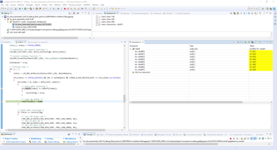

based on s32k118, ide is s32ds, generate lin code by lin example(lin_baremetal_slave)
However, during normal communication with the master, an error frame occurs as follows
Here there are two LIN frames : ID 1 - Request Frame , ID 2 - Response Frame
During normal communication with the master, an error frame occurs as picture
1) CSerror(checksum error)
2) RCverror(8 bytes of data, but only 1 to 2 bytes of data sent)

I think there're 2 points that you can try with your app:
- Increase the TIMEOUT param from the code
- Update the DS to update 2 and try the newer version of SDK.

Hi mose,
I checked the example and saw the Rx Buff receive data correctly when i press button for sending.
I tried to observe the data with DS tool few times and there's no error happens.
I checked with lin_slave and lin_master example from DS 2.2 SDK 3.0.0
Please help me to check it again.

Just to confirm, can you give me the name of Lin Example?
Also please provide the name of RTD package version that you're using. And how can you test/observe this issue?

example name is lin_slave_baremetal_s32k118 and
SDK name is S32K118_SDK ver3.0.0
