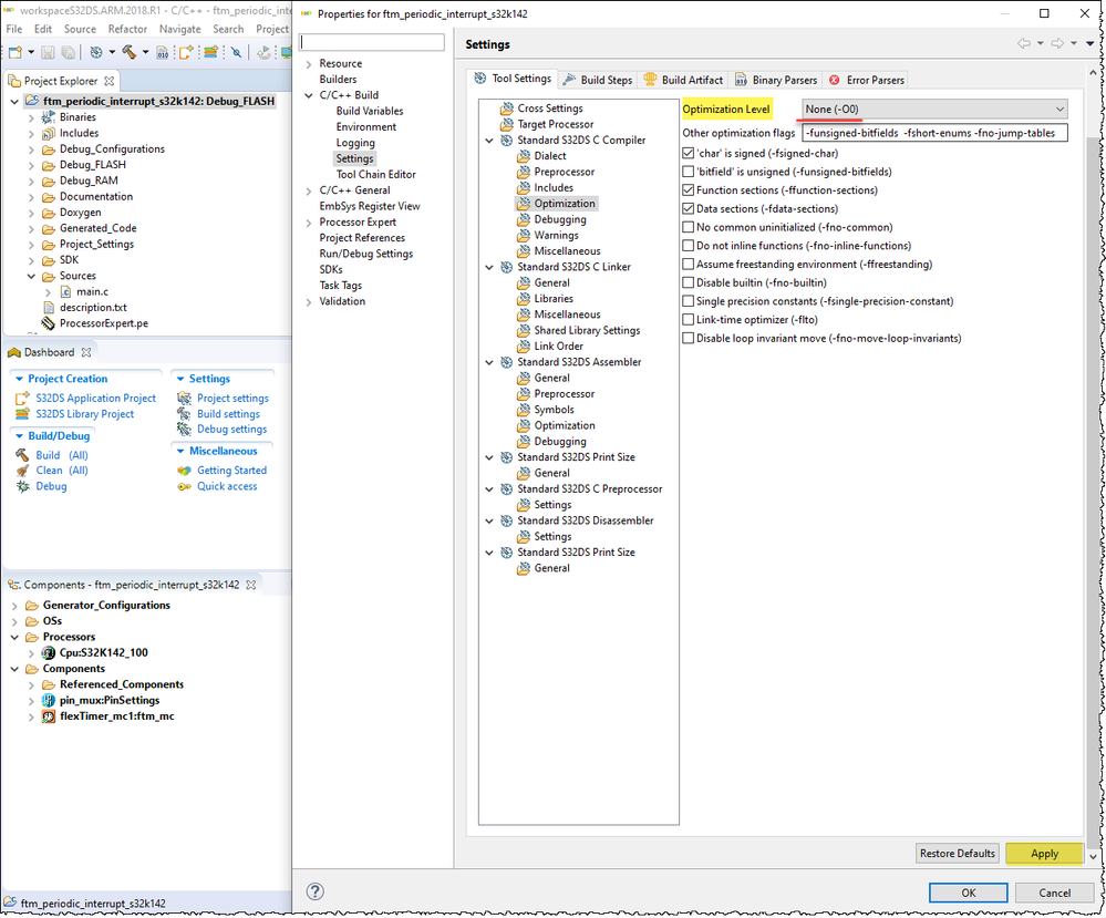

Please select None(-O0) for Optimization Level.
Robin

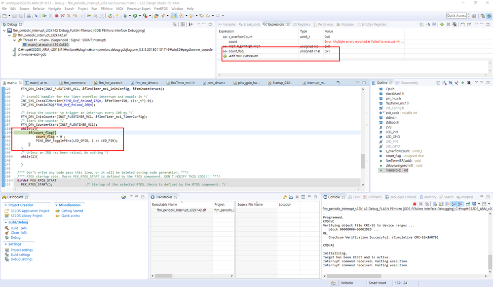

jtpark
Dear Robin,
Thank you for kind answer.
I changed the optimization to "none" but it was not working.
Did you set the break point at the "count_flag =0" ?
Thanks.

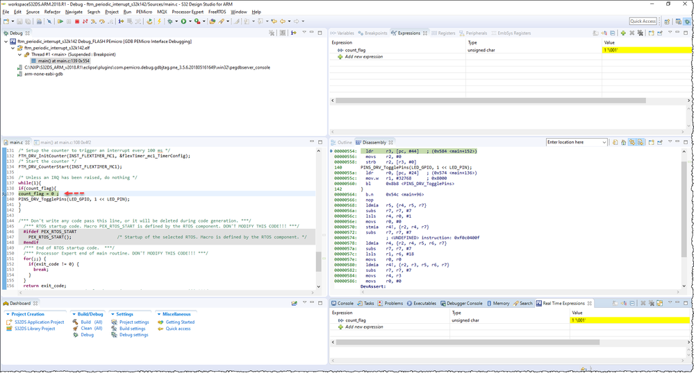

Break point at count_flag will stop the debug. You can see the count_flag=1.
I directly copied the entire main.c to the ftm_periodic_interrupt_s32k142 project and test it on S32K142EVB.
