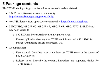

lukaszadrapa
there's integrated LWIP stack and wolfSSL library in SDK in S32 Design Studio IDE:
https://www.nxp.com/design/software/development-software/s32-design-studio-ide/s32-design-studio-for...
From release notes (c:\NXP\S32DS_Power_v2.1\S32DS\software\S32_SDK_S32PA_RTM_3.0.3\doc\ReleaseNotes_TCPIP_PA.pdf):
And from the TCPIP User Manual (c:\NXP\S32DS_Power_v2.1\S32DS\software\S32_SDK_S32PA_RTM_3.0.3\doc\TCPIP_USER_MANUAL.pdf):
Lukas

lukaszadrapa
it's integrated to SDK. There are some sample codes like:
c:\NXP\S32DS_Power_v2.1\S32DS\software\S32_SDK_S32PA_RTM_3.0.3\middleware\tcpip\tcpip_stack\apps\secure_socket\
Lukas
