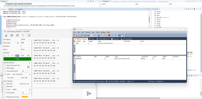

In my project, I hope CAN2 can send the following data that  ID is 0x10001,  so it's an extended frame;
Expected to the CAN0 can get ID 0x10001 as well , but the ID received by CAN0 is 0x01,  why?

Senlent
Hi@fedora
There is no problem with receiving. The error is that you are not sending an extended frame.
place "CAN_ConfigTxBuff()" before "CAN_Send()"

1,330 Views
fedora
Thanks, Senlent!
After testing, your method is correct.
Before calling Can_send, Tx buffer needs to be reinitialized.
