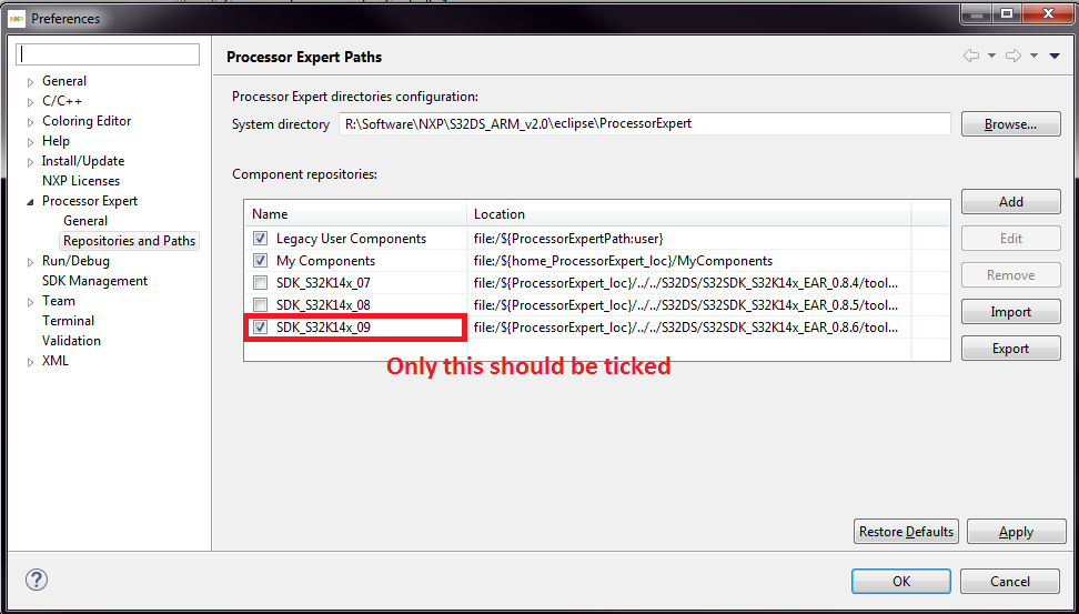

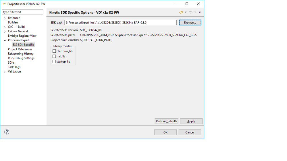

I created a project with SDK 0.85. Now I installed the latest update 3 with SDK. 0.86 and  processor expert update.
I changed the SDK from 0.85 to 0.86.
Now I have the problem, that all the components I had defined in the PE are missing.

Hi Rares,
I have a other Window for change PE path ?
Wich S32DS version do you use?

Hi Lutz,
One workaround would be to disable older SDK repositories from Window->Preferences->Processor Expert-> Repositiories and Paths and then import the components as described in the post above.
Some of the component properties types have changed from one release to another and will require reconfiguration.

Hi Lutz,
here is workaround  - before switching workspace you can export processor expert settings and after workspace update import it.

koehlerl
Hi Jiri,
when I use this workaround the components are use the “old” repository.
I want to use the new SDK with the old configurations from the components.
I tried to change the repository for the components separate, but then then configuration in the components changed.
