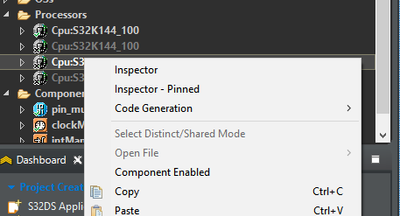

According to this post, I am able to switch to a new processor package by adding a new package and clicking the switch configuration button.  This works as explained.  The problem is that once you have both packages installed, how do you switch between them?

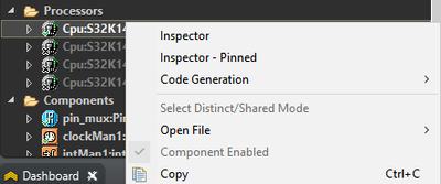

The answer is that you right click for the context menu and select "Component Enabled", which doesn't sound like an option but rather the status of the processor.
In fact, it wasn't until I noticed that on the processor that is actually enabled, that option has a check mark and is greyed out, that I realized what was happening. There is a sizable delay between the time you click enable and the time the x switches to a checkmark so it's not immediately obvious that it has worked.

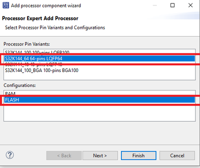

I have checked the version S32DS.ARM.2.2 and SDK RTM 3.0.0. And it is normal. If you just choose one configuration (Just FLASH or RAM) and just one "Processor Pin Variants", then just one processor is added. Could you please help to check if you have choose both RAM and FLASH in Configurations.

There's the answer, it creates a processor for each configuration.  Thank you!
