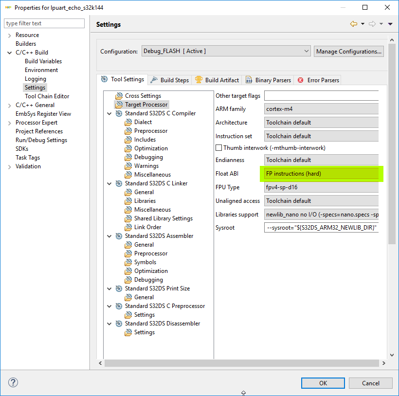

My configuration is under S32K Design Studio.
After Build, I encounter below build error...
S32K144-100 with FreeRTOS via Processor Expert.
C:\Users\jwyum\AppData\Local\Temp\ccs6nUFH.s:708: Error: selected processor does not support Thumb mode `vstmdbeq r0!,{s16-s31}'
C:\Users\jwyum\AppData\Local\Temp\ccs6nUFH.s:710: Error: instruction not allowed in IT block -- `stmdb r0!,{r4-r11,r14}'
C:\Users\jwyum\AppData\Local\Temp\ccs6nUFH.s:731: Error: selected processor does not support Thumb mode `vldmiaeq r0!,{s16-s31}'
C:\Users\jwyum\AppData\Local\Temp\ccs6nUFH.s:733: Error: instruction not allowed in IT block -- `msr psp,r0'
make: *** [SDK/rtos/FreeRTOS_S32K/Source/portable/GCC/ARM_CM4F/subdir.mk:35: SDK/rtos/FreeRTOS_S32K/Source/portable/GCC/ARM_CM4F/port.o] Error 1

You can also try to modify the port.c file, at the xPortPendSVHandler method. The assembler instructions "vstmdbeq" and "vldmiaeq" cannot be compiled with Library Soft option (-mfloat-abi=soft)
Attached you can find the modified file, more specifically you can find the changes on lines: #451, #456, #475, #479.

jiri_kral
you need to enable hardware float point support in project properties (right click on project name):

yumjeongwon
Oh! It working well. Thank you for your reply......
