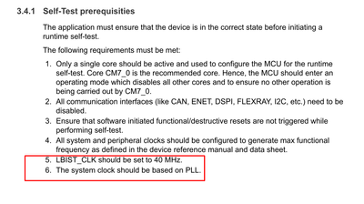

Pusoy
Hello,thanks for your reply.
Setting PLL in MCU mode control set the clock to system. It does not mean the BIST will run from PLL.
However, according to the two images below, for S32K344, if the clock signal generated by PLL is used as the source of the system clock, then STCU2 will also run from the PLL.
