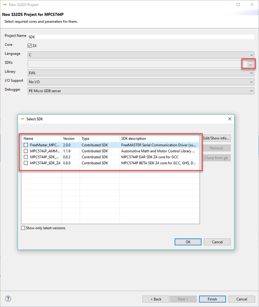

When I new a project,how can I insert SDK in S32DS? It's about SPC5744P
3,125 Views
martin_kovar
in New Project wizard choose MPC5744P and on the next screen, there is SDK line, which allows you choose SDK, you want to use. Please see the figure below:

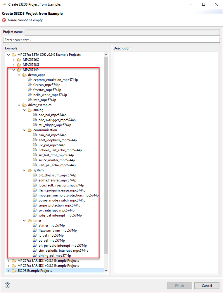

How can I find a example project based on those SDKs?
3,125 Views
martin_kovar
in S32DS, click File->New>S32DS project from example.
and choose example you want to use for MPC5744P.
