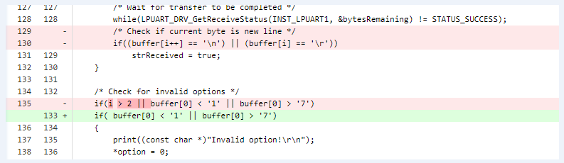

I prepared example code for you (in attachment).
I simply use power_mode_switch_s32k144 example code as a template and add there LPTIMER component.

Please be aware that power_mode_switch in SDK0.8.4 sometimes behave strangely (ignore inputs from the terminal) because it waits for EOL char (\r or \n) – please use Enter button with number char for your power mode choice.
This example works like a charm with SDK0.8.5 due to minor changes in the main code:
