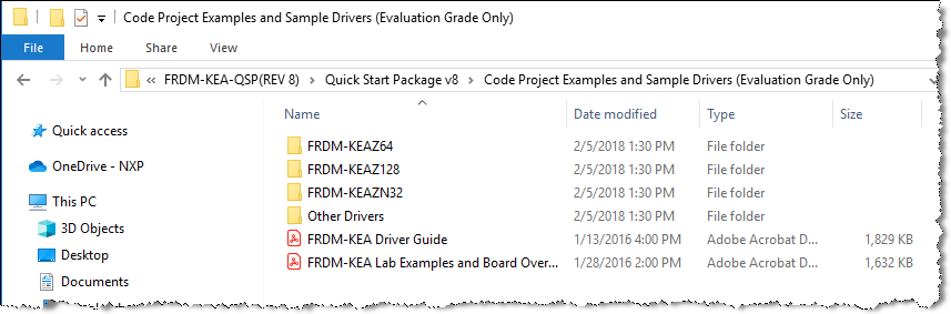

Is there an SDK avliable for the SKEAZN32.
Under new S32DS Project
     Select SDK
              Only KEAZN64 is listed

Customer should download the FRDM-KEA Quick start package (REV 8 ) from FRDM-KEAZ128: KEA Freedom Evaluation Board.
Please use S32DS-ARM: S32 Design Studio IDE open these examples. You can download the latest S32 Design Studio for Arm 2018.R1 – Windows/Linux(REV 2018-R1).
But the FRDM-KEA Quick start package (REV 8 ) download from that link was broken at the moment. Please submit a Support Requestsand comment: assign to Robin Shen, so that my colleague will transfer your case to me.
Then I can send this file to you through case.
Sorry for the inconvenience we bring you!
