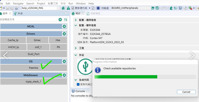

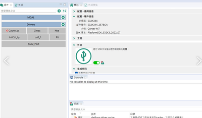

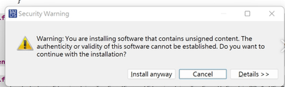

During the installation of RTD 2.0.1, the following figure 1 appears: How to solve this problem? , When we press install anyway, the RTOS and lwip cannot be used as shown in Figure 2 below. If we normally use the SDK of the previous version of RTD 2.0.0, we can use RTOS and lwip module as shown in Figure 3 below. Could you please help to see what the problem is?

Unfortunately, these latest TCP/IP and FreeRTOS packages are only compatible with RTD 2.0.0. You need to downgrade the RTD version to 2.0.0 in order to use them.
