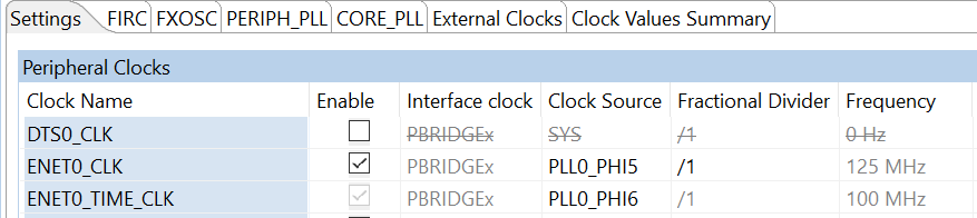

I am testing S32R294 ENET using S32SDK  lwip TCP/IP stack project. I have some issues.
when I configure MII mode as RGMII, MII speed as 10M. The ENET works normal and  I  pinged my own address and it was OK.
However, when I change the MII speed to 100M or 1000M. It can not work.
How can I solve this problem?
Andy

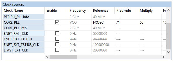

lukaszadrapa
Hi Andy,
here is the feedback from our lwip expert:
It works with 1GB RGMII in tcpip, we already supported this speed for S32R294. I confirmed.
In customer question on community, I understand that he is using default configuration of clock (without modification for ENET Clock)
You can checkout lwip_s32r294 example, where we configured default RGMII/1GB speed already.
The ENET clock (ENET0_CLK, ENET0_TIME_CLK) should be configured like this for 1GB:
Lukas

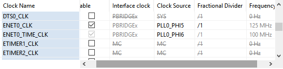

nxf55006
Hi, Lukas
Thanks for you information.
I have correct my clock configuration. And it worked OK with RGMII 100Mbps. However it still failed with 1000Mbps. I noticed there was a macro called "PHY_KSZ9031_SPEED10_100".  Does it limit the transmission rate?
Here is my ENET clock configuration.
Andy

nxf55006
Thanks for your information. I have imported example lwip_s32r29 demo and just chane speed to 1Gbps. It still does not work. However when I run the enet_ping_s32r294 demo it works OK.
Could you please provide me the lwip demo passed test?
Andy

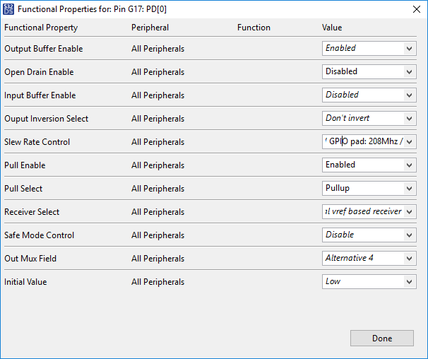

taibuivan
Hi Andy,
If you want to run example lwip_s32r294 demo with speed 1 Gbps, you should configure as below:
- In TCPIP configuration: set TX ring size and RX ring size to 5.
- In pin configuration: setup Ethernet Transmit Data 0 -> 3 (PD[0], PD[3], PD[4], PG[10]) and Ethernet Transmit Enable (PC[15]) in ENET tab as figure below
Tai Bui Van
