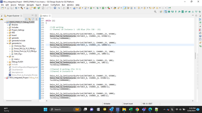

Hi Team,
@Senlent
I've loaded PWM generation example code for s32k312 and tested. It was working as expected.
The example code versions are below and also please find the attached screen shots

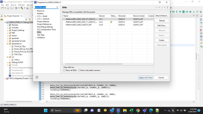

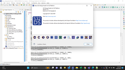

Version 3.5
SDK 2.0.0
I Created a new application project using below configuration.
Version 3.5
SDK 3.0.0
Here, it is not working as expected.

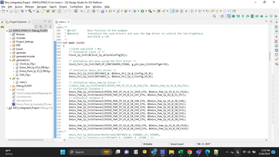

If I configure one channel it was working and we could able to see the correct frequency & duty cycles in the scope, but if I configure more than one channel, the last one only working as expected. The first two channels are not working.
Emios_Pwm_Ip_SetDutyCycle is disabled in generated code.

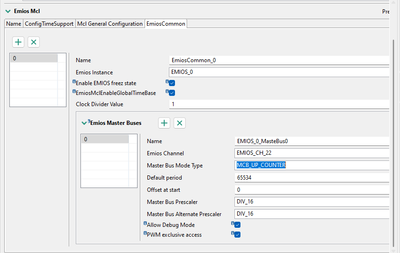

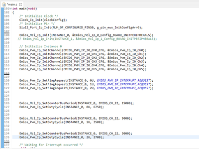

NITHYANANTHVS
Hi @Senlent
Here we were configuring PWM output for three channels. For Duty cycle they are configuring with channel id. Eg: Emios_Pwm_Ip_SetDutyCycle(INSTANCE_0, 0U, 6750);
But for period they didn't configure for each channel. Could you explain the following queries.
