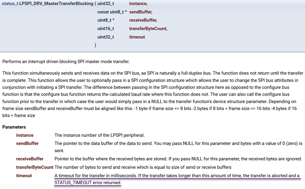

In SDK3.0, there are two ways to send SPI, one without blocking and the other with blocking.When I sent SPI data with a blocking function, the program died suddenly.The reason is that in this function "osifError = OSIF_SemaWait(&(lpspistate-> lpspiSemaphore), timeout);", I want to for what reason is caused, how to solve this problem?Thank you very much!
1、LPSPI_DRV_MasterTransfer(uint32_t instance, const uint8_t * sendBuffer, uint8_t * receiveBuffer, uint16_t transferByteCount);
2、LPSPI_DRV_MasterTransferBlocking(uint32_t instance, const uint8_t * sendBuffer, uint8_t * receiveBuffer,uint16_t transferByteCount, uint32_t timeout);

Hello [email protected],
You need to use a timeout (in ms) longer than what the transfer takes.
Please refer to the SDK documentation in the SDK installation folder:
.../NXP/S32DS_ARM_v2.2/S32DS/software/S32SDK_S32K1xx_RTM_3.0.0/doc/Start_here.html

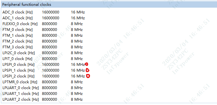

I think I have known the reason for the loss of my spi sending data. In the SDK routine, the baud rate used by spi is relatively low, such as 50K;There was no problem in the test of this communication rate in my code, but when I continued to increase the communication baud rate of spi to more than 300K, spi began to lose frames of data, and the higher the baud rate, the more serious the frame loss.I tried to increase the clock on the lpspi, but it didn't work.Do you have any ideas?

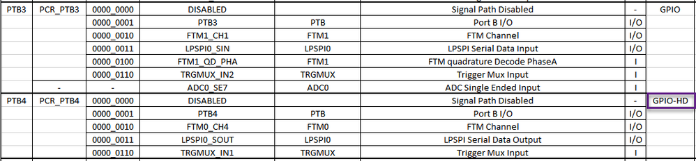

At higher baud rates, please use the GPIO-HD (high-drive pins).
It is configurable in PORTn_PCRn[DSE] register of the GPIOs that support it.
In S32K146_IO_Signal_Description_Input_Multiplication.xlsx, IO Signal Table, Column H.
PE Component inspector:

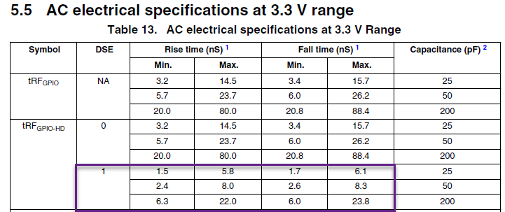

The GPIO-HD pins have better current capabilities and can drive the SPI bus faster:
The signal depends on the electrical parameters of the SPI bus as well.

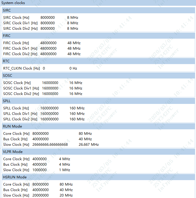

Instead of increasing the SPI functional clock frequency, try using a higher CORE/SYS_CLK frequency, maybe the issue is related to the CPU overhead.

In "IO Signal Table", S32K146 gpio-hd pins are relatively few, and I have already used all three lpspi. There seems to be no gpio-hd function in my three spi. I wonder if the ordinary GPIO of S32K146 can't support such a high spi communication rate (such as 1M)?Generally speaking, microcontroller spi at 1M communication rate is not high, S32K146 such a powerful microcontroller should not have this problem, if I want to use so high spi communication baud rate must modify the hardware (spi pin specified gpio-hd)?My MCU bus has been configured so high that I really can't figure out where my problem is. Can you help me?

The GPIO-HD ports have better current capabilities and therefore the slew rate is better.
But the signal depends on the electrical parameters of the bus + on the probe you are using to measure the signal as well.
You should be able to see the signal on the scope.
I just mentioned it as a thing to consider.

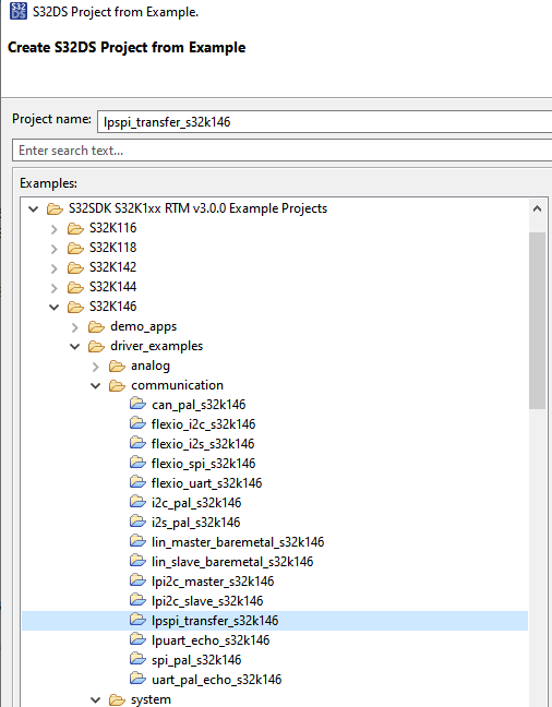

Please start with an SDK example
You should be able to increase the baud rate without any problem.
