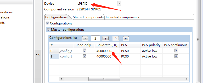

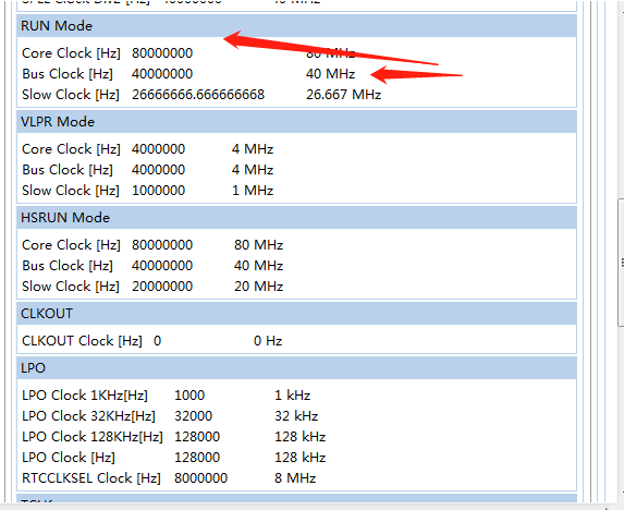

and seeting  nterface
but logical analyzer always  4Mhz
of course LPSPI Baudrate is 40MHZ
how to set 40MHZ baudrate

S32 Design Studio for ARM v2.2  ProcessorExpert  Configuration  in  LPSPI_CLK.png  file
4,616件の閲覧回数
wjandsq
SPI functional clock (source clock) can be set max 80MHz in Run mode ,  Function Clock select SPLLDIV2_CLK for 80MHz.
and ProcessorExpert.pe  Components  lpspicom1: lpspi  Baudrate (Hz) is set 40000000,   Clock Source is 80000000 is read only.

Baudrate = SPI functional clock / 2^TCR[PRESCALE] / (CCR[SCKDIV] +2)
Since the  SPI functional clock (source clock) can be set max 48MHz in Run mode and
The SCK period is equal to (SCKDIV+2) cycles of the LPSPI functional clock divided by the Prescaler Value TCR[PRESCALE] configuration, so, theoretically, we cannot set a baudrate more than 24 MHz.
However, you can see that the baudrate can be set max to 10MHz in Run Mode in "Table 46. LPSPI electrical specifications" in the DS rev 13.
Using the Master Loopback feature you can set max 20 MHz in Run Mode when MCU runs at 5V power supply.
