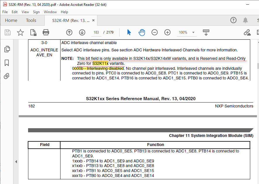

Now I see that in S32K118_features.h there is a macro FEATURE_PINS_HAS_ADC_INTERLEAVE_EN which is defined as (0), so I am not sure it would work. It seems like it is not available on this chip. Any other ideas?

You need to initialize ADC peripheral and GPIO output. But before ADC sample that channel, please change the pin from GPIO output to ADC input.
Since S32K11x does not support ADC interleave channel, the macro FEATURE_PINS_HAS_ADC_INTERLEAVE_EN defined as (0).
