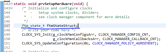

I want to control the rgb brightness in s32k144 dev board, run the example "ftm_pwm_s32k144" successfully, I can see the red light brightness changing.
While porting the code into my project(based on FreeRTOS), I config the FTM1 and add the code to initialize the pwm and call the function to change the duty cycle, but cannot see the brightness change, anyone can help me with my issue?
Attach the project as attachment file.

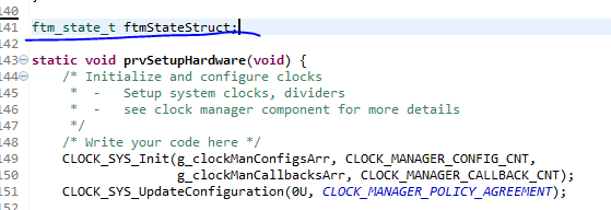

Seems like the FTM state structure is allocated on the stack, so its contents get invalidated after the prvSetupHardware function returns.
To fix this, in the rtos.c file, in function prvSetupHardware, at line 147: please move the ftmStateStruct declaration outside of the function body. This way it will be allocated in the .data section.
to
Ovidiu

jay_zhang
Thansk Ovidiu,
It works
