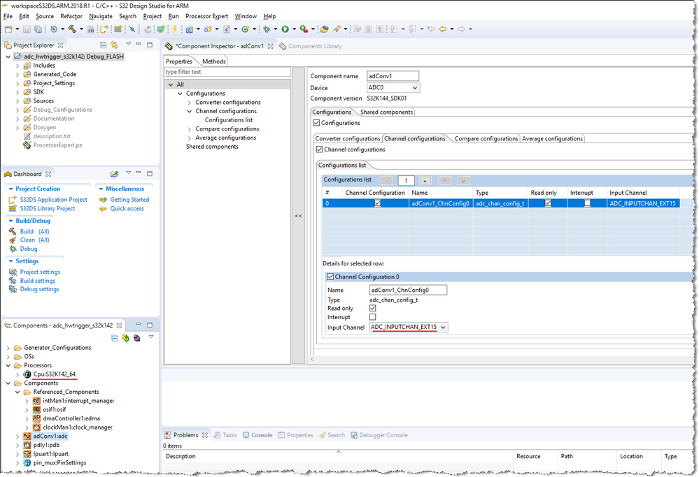

I use S32K142_64pin, ADC0 channel15.
Processer Expert Problem: ADC1 of S32K142_64 has only 11 external input channels.
But ADC0 has 15 external input channels.
I's it a BUG?
How to solve it.

I am able to select ADC0_CH15 of S32K142_64pin.
You may need to change package, please refer: How to change package on S32DS Processor Expert
The adc_hwtrigger_s32k142 example is from RTM3.0.0
For S32K1xx, the recommended SDK version to use is S32K1xx SDK RTM3.0.0 with UP10(SR3.0.1) and 11(SR3.0.2) installed;

Thank U. It need to update the SDK.
