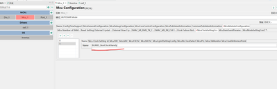

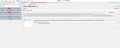

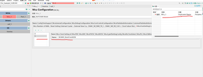

Hello, I am on S32DS 3.5 + S32K3 RTD 2.0.0. I'd like to add a configuration in McuModuleConfiguration/MCuClockSettingConfig, hint I appeared a mistake. The reason for the error is the duplicate name, I tried to change the name, but could not succeed.The name cannot be changed to BOARD BootClockStandby

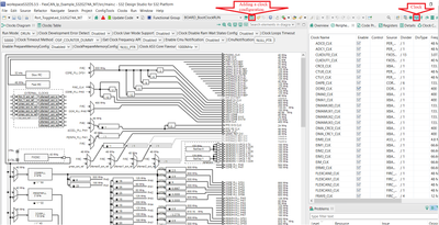

No, it's not a bug
On s32ds, the clock configuration is configured by Clocks Tool:
