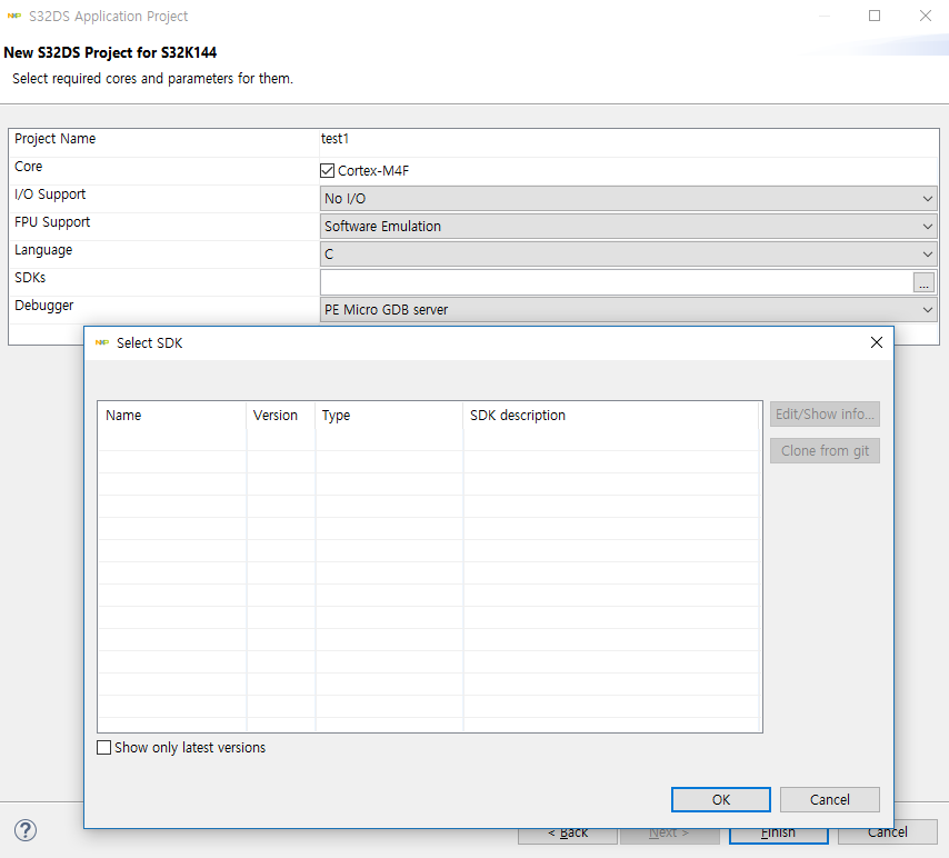

Hello.
To create IAR SDK project, do I need to install IAR 7.x?
I just installed IAR 8.x at my laptop.
but, if I create S32DS project based on 'IAR 8.x toolchain' there is no selectable SDK list.
if I create 'IAR 7.x- SDK' project, S32DS shows error finding IAR 7.x toolchain. (But, I didn't installed it.)
So, I wonder I must install IAR 7.x to create SDK project at S32DS.
Added with it, is there approximate schedule to support IAR 8.x SDK?

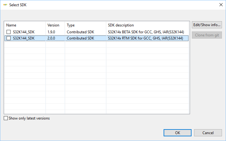

Hi Mac,
What version of S32 SDK you have installed in S32 DS? S32 SDK supports IAR 8.11.2 starting from BETA 1.9.0.
Rares

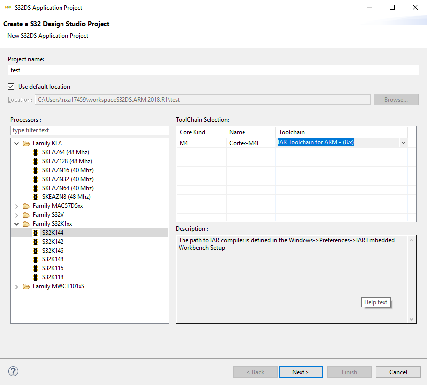

mikedoidge
Hello jongcheonkim‌,
When you used the New Project Wizard, did you select the correct Toolchain option as below?
After selecting the correct toolchain, then click next and you should be able to select the SDK.
Please let me know if this does not resolve your issue.
Mike

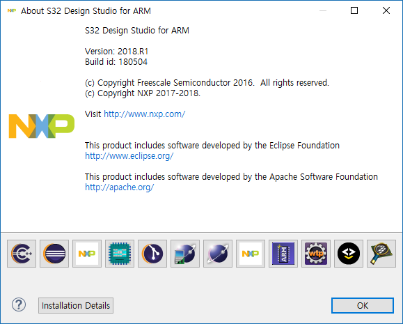

jongcheonkim
Hello. Mike.
Sorry, I missed my 'S32DS for ARM installation details related IAR' for your reference.
Mac.

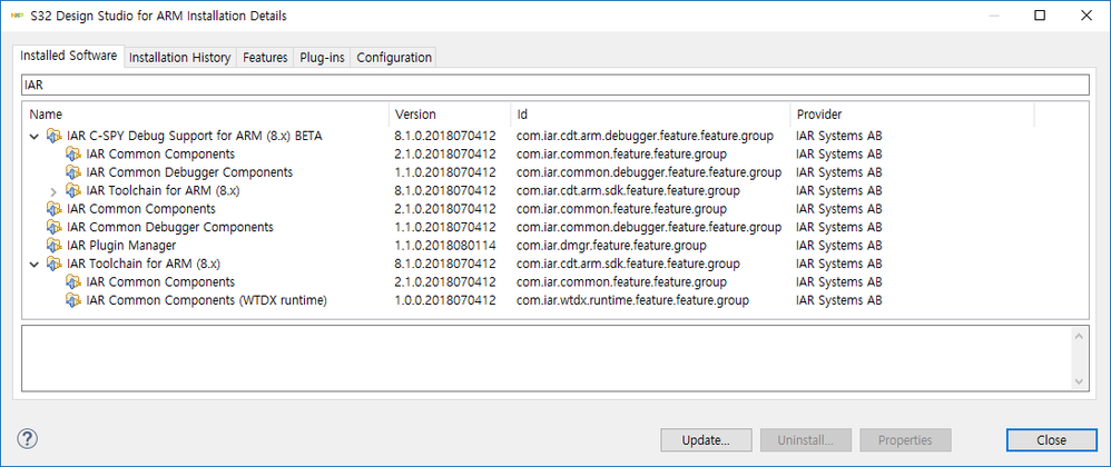

jongcheonkim
Hello. Mike.
Thank you so much for your help.

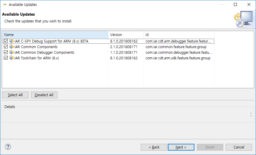

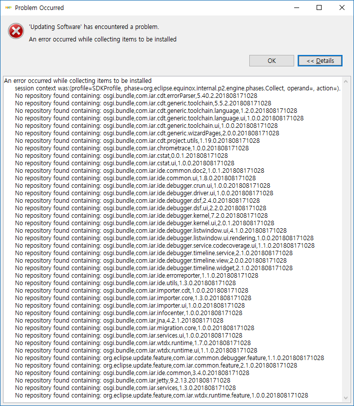

After I select IAR 8.x Toolchain, there is no SDK list.
I think that it may comes from during install S32DS update related IAR, I have some errors.
Do you have any idea how can I avoid it?
This is about my S32DS for ARM information
Mac.
