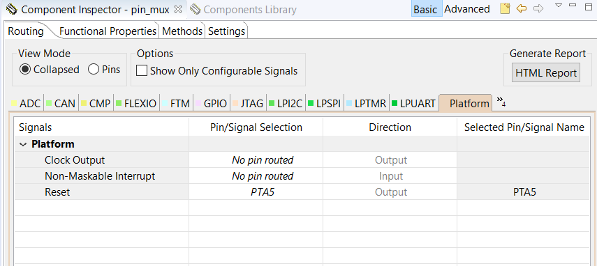

I'm having trouble figuring out how to map (or...confirm the mapping of) the oscillator pins for a S32K116
There don't appear to be any EXTAL or XTAL signals in the Platform components like there are for this S32K146
As far as I can tell, the two projects are set up in similar manners...but I'm new to S32DS...so I assume I'm missing something trivial.  I'm just not sure where to look.

do you know why it is defined in different way on S32K11x? I can see that on S32K14x XTAL and EXTAL signals are defined in Platform section but that's not the case of S32K11x. Not sure what is the reason, the functionality is the same. The pins are shared with GPIO/I2C in both families.
