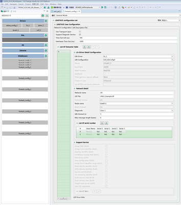

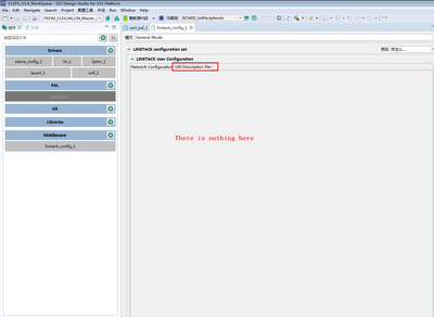

Hello there!
The software I use is S32DS V3.4+S32K144_SDK 4.0.1. When using the LIN component, I found that the LIN configuration interface is incomplete and there is no LDF file description interface. I hope to get help, thank you.

Hello @xqcnhz,
You can modify the .ldf file manually in S32DS 3.4
A reference .ldf is attached in the .zip file.
https://www.cs-group.de/wp-content/uploads/2016/11/LIN_Specification_Package_2.2A.pdf
Or you can use S32DS 2.2 that supports this tool,

Hello @xqcnhz,
Unfortunately, the tool is not yet available for S32DS 3.4.
At this moment, we don't know when it will be added.
I'm sorry for the inconvenience,
