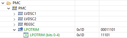

I found that there is one issue with the SDK.
Please load the project and halt the execution before the CLOCK DRV INIT function and read the PMC_LPOTRIM register. It should show the factory trimmed value.
Once the SDK CLOCK driver is initialized, it will change the TRIM value to the one configured in PE.
The non-SDK example does not do that, it uses the default TRIM value.
So, change the PE value to the factory trimmed value (0x1D in my case).
Hope it helps,

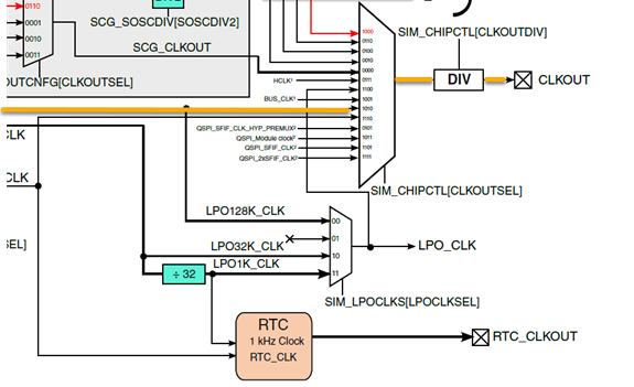

2)
Can you tell me the detailed clock configuration you have made in the SDK. Also for RTC is it required to check the LPO_CLK(marked as 1)?what I understand is, we need to check only the RTC_CLKOUT(marked as 2).RTC_CLKOUT will give 32.678KHz or prescalar output as per our configuration.Based on RTC_CLKOUT compensation need to be provided. I have marked the configuration which I understand as required for RTC with RED line.So only the Input Clock and Clock Out  need to be enabled in sdk for RTC testing...Please correct me if Iam wrong...

2.
The modified SDK example is attached, I only enabled the CLKOUT on PTD10 and RTCCLK_OUT on PTD13.
You don’t need to output LPO clock, but since you are using it and because the RTC module output was wrong, I thought that it would be good if you could measure that.
Yes, RTC_CLKOUT is definitely better then toggling an LED.
But again, you won’t be able to compensate the LPO error.
You need to configure this MUX only:

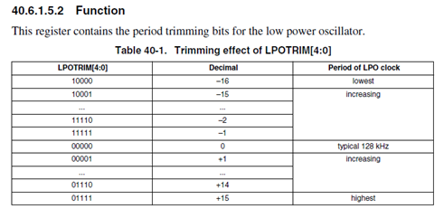

4.
Please take a look at this table, 0x1D is then -3, the trim value differs part-to-part.
In the attached example, I set it to -3, but your chip can be trimmed to a different value.

The oscillator is not precise, as you can see S32DS rev.11.
It is tre-trimmed to around 128kHz (PMC_LPOTRIM), but one LPOTRIM[4:0] step gives about 3kHz difference.
And therefore, the LPO clock can differ significantly part-to-part.
