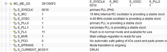

First,I build two new projects。one jumps to other one。Then, I add spi mode and jump to other one。It is dead on clock transfer mode and mode transfer timeout which apps that i jumped。I also try to add fccu mode or freertos mode,anyone cases this problem!
I have never see this problem, anybody can tell why?thanks,i use SDK  RTM 1.0.0.

I used DEVKIT board.
I debug two projects(bootloader and app) by IC5000.
Yes,I tried.  In single project ,the clock mode transfer can be completed.
But,when I jump to app,It is dead. The clock mode transfer like DRUN to DRUN is failed.
Yeah,I have a bootloader and application. The bootloader project pass the clock init,The app clock mode transfer (DRUN to DRUN) is failed.
    The bit S_MTRANS can not become to 0.

I suspect there could be an issue related to a pending interrupt in the bootloader application.
Before you jump to your application from bootloader I'd suggest you to deinitialize drivers.
Since there is no reset before entering application from bootloader the the device is not in the default state.
SDK offers de-initialization API for this purpose e.g. for PIT timer -  PIT_DRV_Deinit(INST_PIT1);
Could you possibly attach your zipped projects if it does not help.
