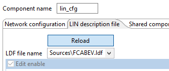

Hi, we are a team developing a project usind the S32K146 MCU. We are currently using S32 Design studio for ARM.
We have a problem with the Git workflow regarding the ProcessorExpert.pe file. The file contains the following section:
<ItemState>
        <ItemSymbol>NPFFileName</ItemSymbol>
        <ReadOnly>false</ReadOnly>
        <UserReadOnly>false</UserReadOnly>
        <Value>C:\Users\lolivieri\Documents\S32MHT\MH7\Sources\LinStackCfg.npf</Value>
</ItemState>
which is different for every developer since the starting part of the file path is different on every machine.
That should derive from this setting:
How to avoid this absolute path?

The part where I say that it should derive from the lin_cfg setting is totally wrong.
Ignore the screenshot.

Hello @olimexsmart ,
one easy workaround would be to locate the Repo of Git always in the same directory. For example C:\GitRepos.
Then it is the same for every user.
Greetings,
Florian
3,779件の閲覧回数
olimexsmart
Thanks Florian,
it's an easy workaround, we will consider it, thanks
