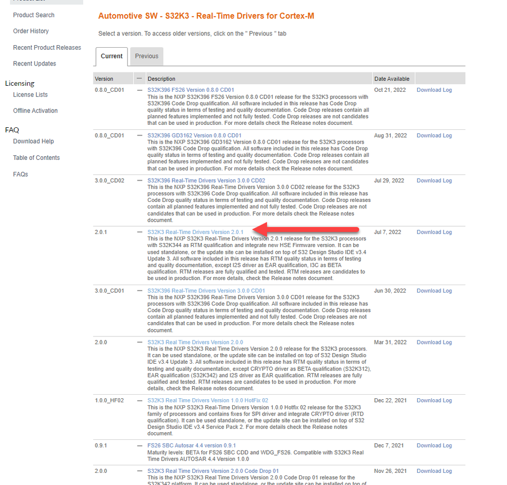

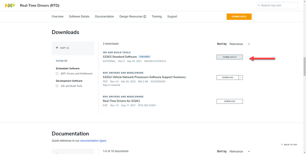

Please go to Real-Time Drivers (RTD) | NXP Semiconductors and follow the next steps.

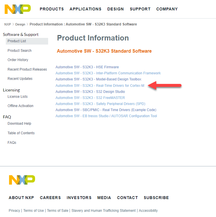

1.- Click on S32k3 standard software
2.- Click on Real-Time Drivers for Cortex-M
3.- Select the version 2.0.1 (note that you need to click on the name and not in the download log)

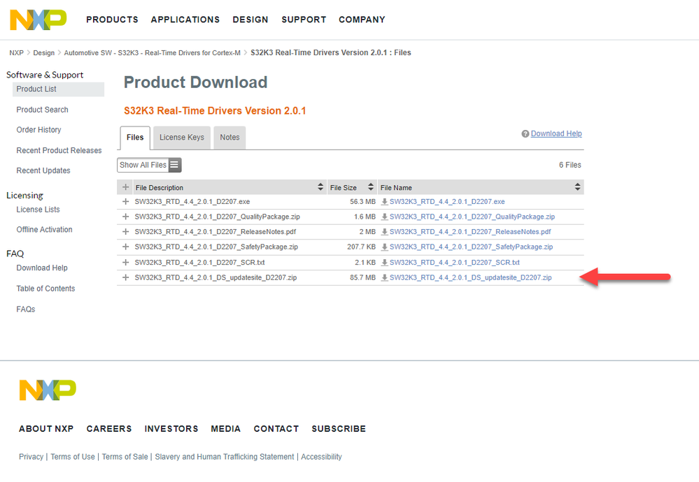

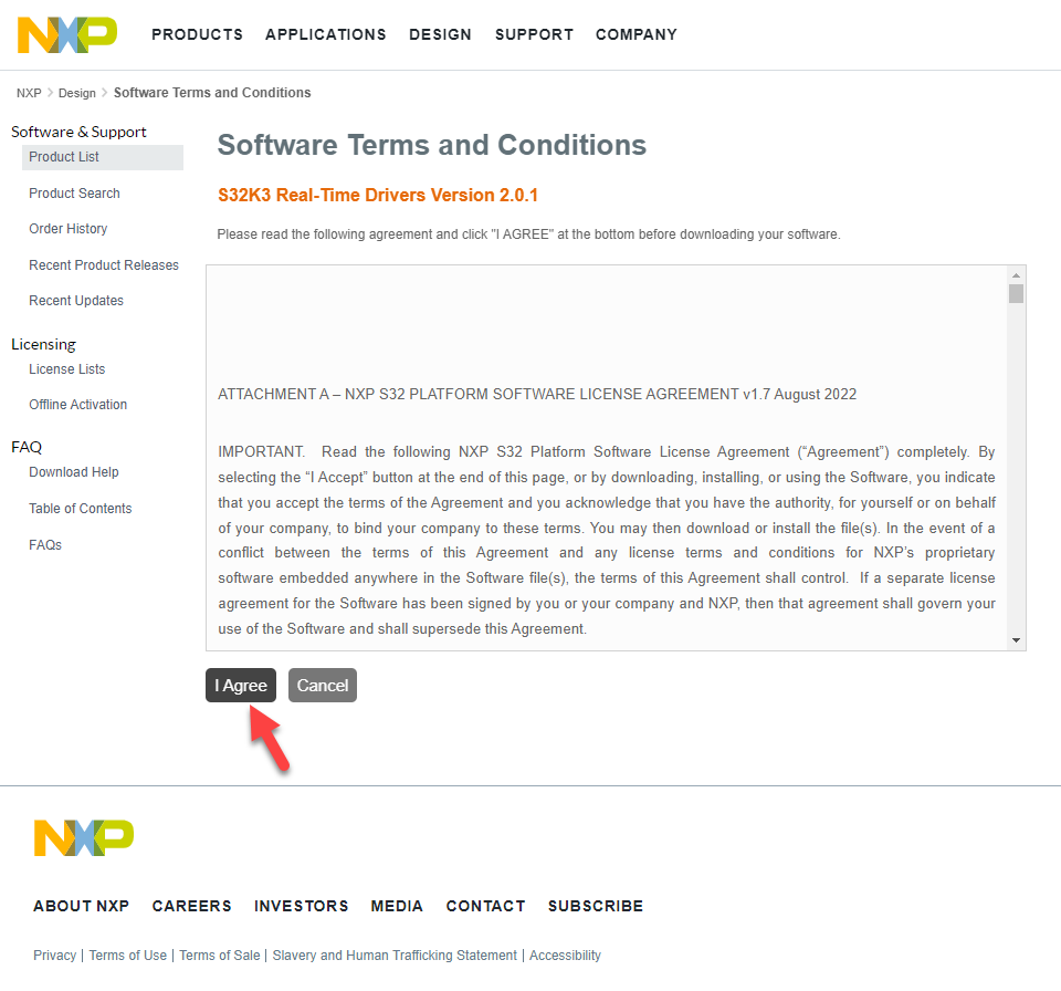

4.- Read and agree with the terms (if you don't agree you can't use the provided software)
5.- Download the zip file

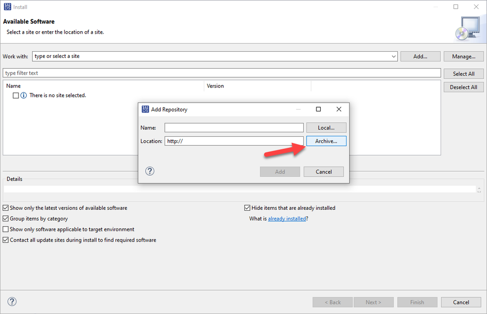

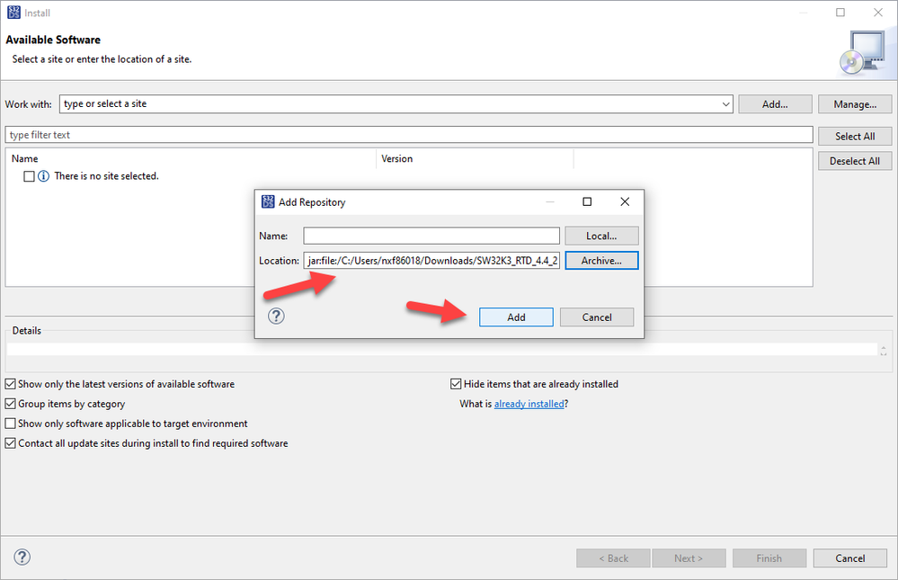

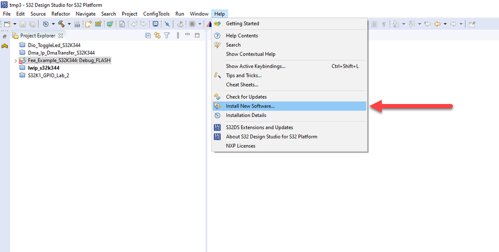

6.- Once it is downloaded, open the S32DS for S32 platform and open the installation window by clicking on the install new software menu
8.- Click on Add
9.- Click on Archive

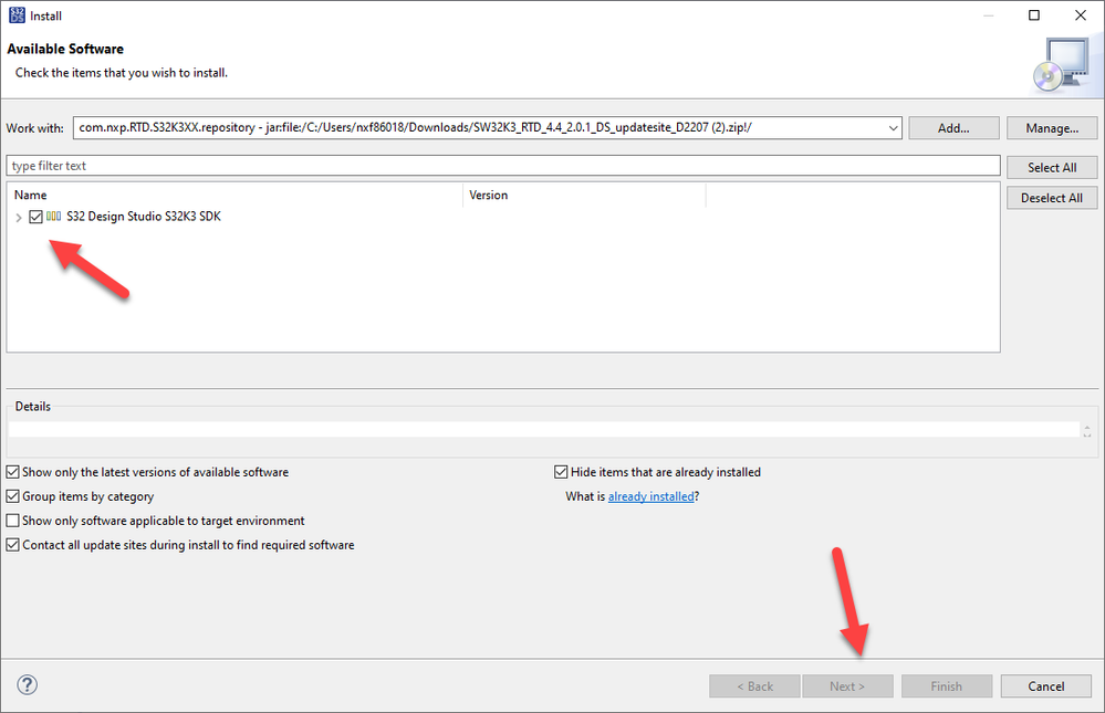

10.- Select the file we just downloaded and click on Add.
11.- Click on the checkbox to select all the packages and click next
From there. you need to accept the licensing and wait the process to finish.

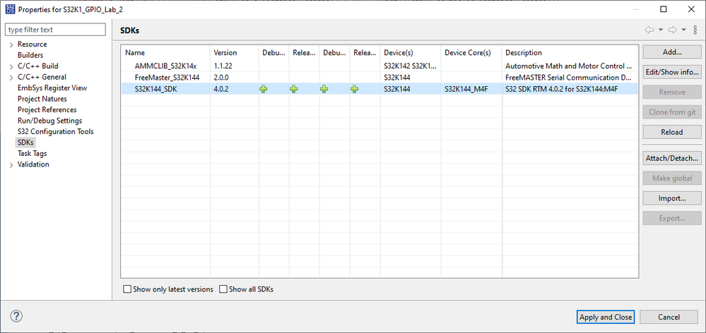

attached are the list of installed softwares
10,691 Views
JRoberto
@mr_jeffs

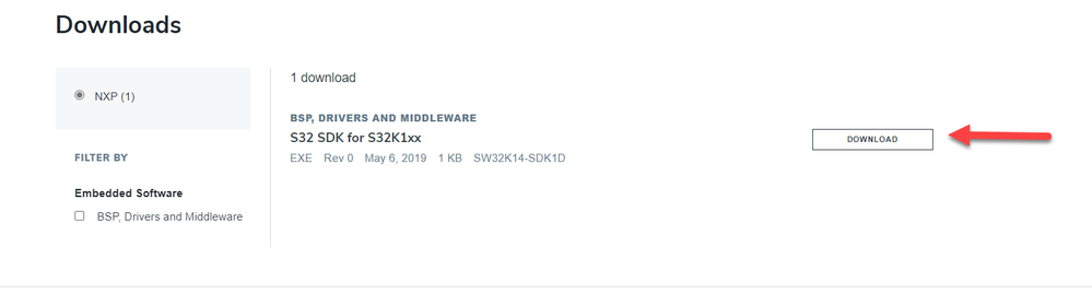

I believe you don't have installed the correct RTD version to work with this example.
Please download the RTD version  4.0.2 from: Automotive S32 SDK for Arm® devices | NXP Semiconductors
Best Regards!

Hallo @JRoberto
As you said, The installed RTD was of old version, but the new version 4.0.2/4.0.3 are not available in S32DS update list and even if we dowload it separately, it can not be added to the S32 Design Studio.

JRoberto
Let's try to install the installation window.
8.- Click on Add
I hope this information helps.
