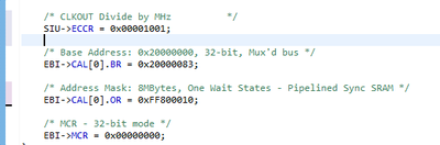

Q1:How to improve external SRAM read/write speed
We extended a piece of SRAM(CY7C1480BV33-167AXI) into our design. The r/w speed is not fast as expected. Did i miss some configurations?
Time cost :1320us, 10KB data copy (byte rw).from external sRAM to external sRAM
The project configuration shows blow.
(1) Enable MMU, Enable DCache and ICache
(2) EBI:66Mhz CLK\32bit mode
(2) MMU:Enable Cache for external RAM and internal RAM
Q2: Is there any example test to determine if the CPU running at highest speed?
We want to know CPU capacity.

Hi, The configuration seems to be correct. You should test performance ideally with 64-bit aligned burst accesses.
You can measure CLKOUT frequency by scope as easiest scope.

1620773328
Thanks very much!
Yes, the CLKOUT configuration was incorrect. The rw speed has great improved after set sram clock to 66Mhz.
