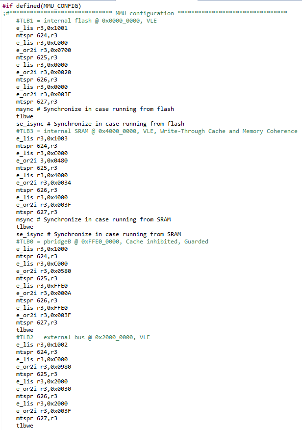

The project configuration shows blow.
(1) Enable MMU, Enable DCache and ICache
(2) EBI:66Mhz CLK\32bit mode
(2) MMU:Enable Cache for external RAM and internal RAM

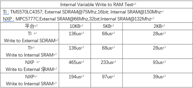

I have a new question about cache. Whether writing external or internal RAM, The writing costs should be identical if cache was enabled and has enough memory to hold the data. My test result shows blow.
Why these two platforms behave differently?微信截图_20200911103131.png微信截图_20200911103131.png

If cache access is configured as write-through (it is being chosen firstly in the MMU TLB and secondly in the cache configuration itself) then write goes directly to the target memory. By default and typically write-through mode is used because it removes potential coherency issues.
If you want basically test only cache write access time, choose copy-back mode.
